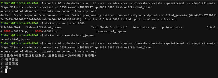

      启动雷达驱动或者microros驱动时提示,端口占用问题
      docker: Error response from daemon: driver failed programming external connectivity on endpoint infallible_proskuriakova (debfb01090b05c2f1f5d12202f1bb2fca86aa480f38e4c946dec870df425930f): Bind for 0.0.0.0:8889 failed: port is already allocated.
      原因是端口被占用,最大可能是重复或者多次启动了该镜像
      通过docker ps -a | grep 8889
      可以看到已经有一个启动了的
      3f7c920c8b44   fishros2/fishbot_laser                  "/bin/bash /scripts/…"   14 minutes ago   Up 14 minutes               0.0.0.0:8889->8888/tcp, :::8889->8888/tcp                       xenodochial_jepsen
      接着我们尝试将这个容器关掉
      docker stop xenodochial_jepsen
      再次启动,就可以了
